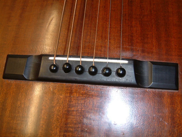

In about my very first post on the OLF I sought advice on fixing an early 1900's all mahogany parlour guitar. Well "guitar building time" moves in it's own sweet way and I finally have a slot to devote some attention to this lovely guitar. I need to remove the ebony bridge to fix the cracks between the bridge pin holes. Given the guitar's age I guess it will be glued with hhg. To loosen this you need both heat and moisture.
The heat bit I can do as I have the lmi bridge heat blanket but how do you go about getting the moisture into the joint? Do you have to get a sharp edge into the bridge joint partly first to give a route for the moisture? Do you mist spray and then apply the heat?
Any methods from you repair gurus would be gratefully received.Dave White38972.2470486111

Thanks for all of your suggestions.
Kim - I like the idea of getting plastered
Alan - thanks for this. I will try it as you suggest. I hear what you say about a new bridge but as this one has hung around for 80 year's or so if I can get it off cleanly and glue it back with hhg, I'd rather give it the chance of a few more years:
I'm thinking that the mahogany top will behave a lot better than spruce wrt avoiding taking a lot of the top wood as well.
